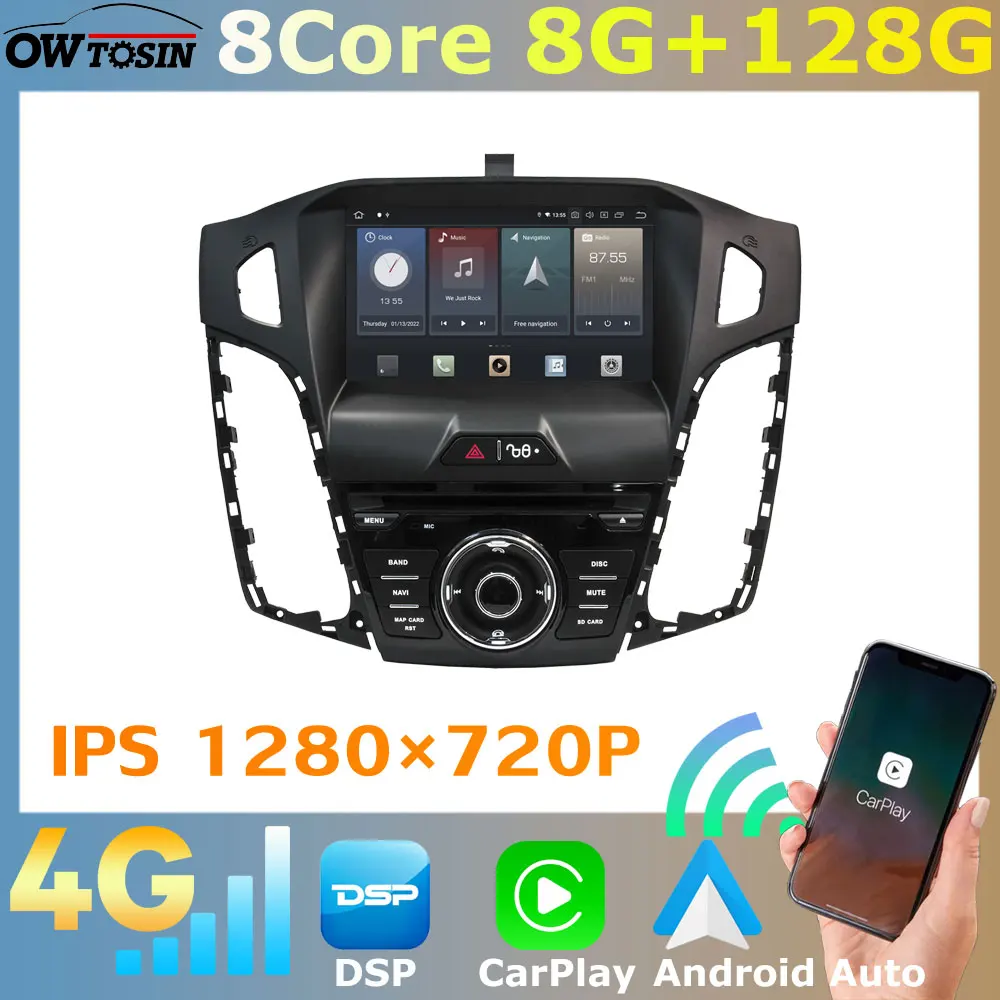

You could go aftermarket, it's cheaper and easier, using something like this.
Rumours on the net are it's not that great, but you will have to research that further as it's not for me.

Appreciate this Neil. I've upgraded to an aftermarket headunit in an old car and definitely true.. They aren't great.
The first option definitely seems best.
