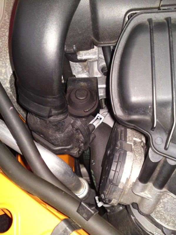

Ive had my Baileys dv25 dump valve delivered to me and I'm planning to fit it over the weekend. i had a look under the bonnet and after reading the Baileys instructions I'm sad to say i am still abit unsure on a part of it
when replacing the OE hose with the samco hose does that boxy looking thing to the left of the picture stay were it is or has it got to be removed?
i only ask as when looking there its seems a bit tight for the samco hose to pop threw the middle of it.. is it a tight squeeze?
many thanks Nathan

Yes mate it stays there, the samco just fits through, i uncliped the boxy bit (symposser) to give me a bit more room when fitting the DV then clipped it back on when finished.
Hope you have small hands..

thats great cheers mate. will have a go over the weekend. and nar not got small hands so i guess a lot of cuts and swearing then lol
any more advice when fitting mate
thanks for the reply

just done mine today ,took headlight out to allow better access but still a fidly job to do and as for the ford clips on the hoses well you even strugle to get the pliers/grips on them .
i took the symphoser out attached the end of the fitting kit and done the jubilee clip up before putting the unit back in then as units going in you can guide the other end in as you go .
worst bit was takeing the old pipe off ,ripped my hands a fair bit i can tel you !!
if you get stuck fitting yours then PM me and il show you how to do it if your local to myself mate .

i tried fitting the DV today as i finished work early. and what whappend?.... DISASTER!!
I got the front light of easy and then the rest was a pig
i struggled to get the spring clip`s off then get the hose and symphoser out. once i managed this the swearing started. i couldn't get the samco hose in the other end (ie not the symphoser end) and the bit that goes straight up kept hitting the air con pipes so it wasn't sitting right .
so i tried to fit it to the symphoser first them put it threw the gap and connect the other end..mmm NO WAY WAS THAT GOING IN THE GAP..
so as it started to get a bit dark i decided to put the OE parts back in and do it when i have a full day of light to try. and that was a pain in The ass and to top it off i manage to drop a spring clip down in the engine somewhere. after an hour searching with the spot light me and my dad manage to find it thankfully.
so now its all back to normal with no problems as such.
just really deciding now weather i should try again to fit it
can any one help
