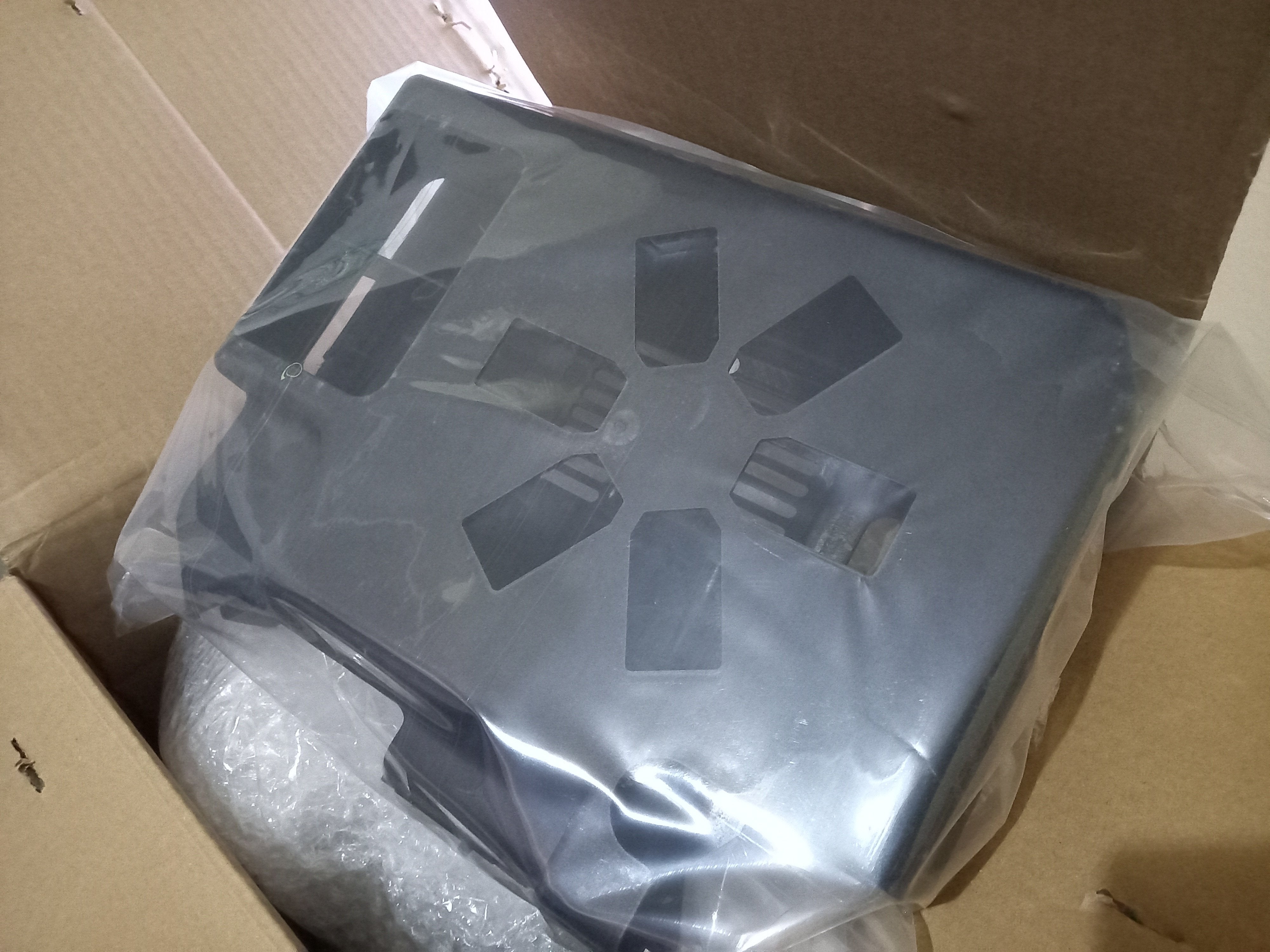

My airtec ECU holder just arrived.The order was placed on 22/5 and arrived today.The RS vac pipe was ordered on 20/4 and i still have no idea where it is....that is the first and last time i use customod!

I fitted the ecu holder,plenum cover and removed the bottom mount intake for now.Everything went smoothly until it was time for the test drive.
